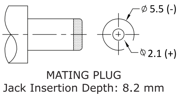

If you choose to run with an external DC adapter, we recommend you to pick one from an established supplier. The adapter should be low noise, approved for IEC 60950-1 as a Limited Power Source. The output from the DC adapter can be in the range 7-20V, max 5A. Pick an adapter that is able to provide a little more than the output power you will need. Be aware that the voltage drop in most cables at 5A is not negligible.

For this you should use an external DC adapter. There are many good ones available, and we recommend you pick a certified one of good quality with sufficient power rating and 7-20VDC, max 5A output. One example is TRH70A180-11E03 VI from Cincon Electronics Co. LTD, and available through digikey.com but there are many more to pick from.
