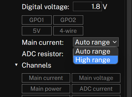

You can also change setting from Auto Range to High range (this increases the maximum output voltage from 3.75V to 4.2V) The drawback with this is that the measurement for low currents are not as accurate as in Auto range mode.
High range setting
If you both change to high range mode and plug in a DC adapter, the maximum output voltage increases from 3.75V to 5V
