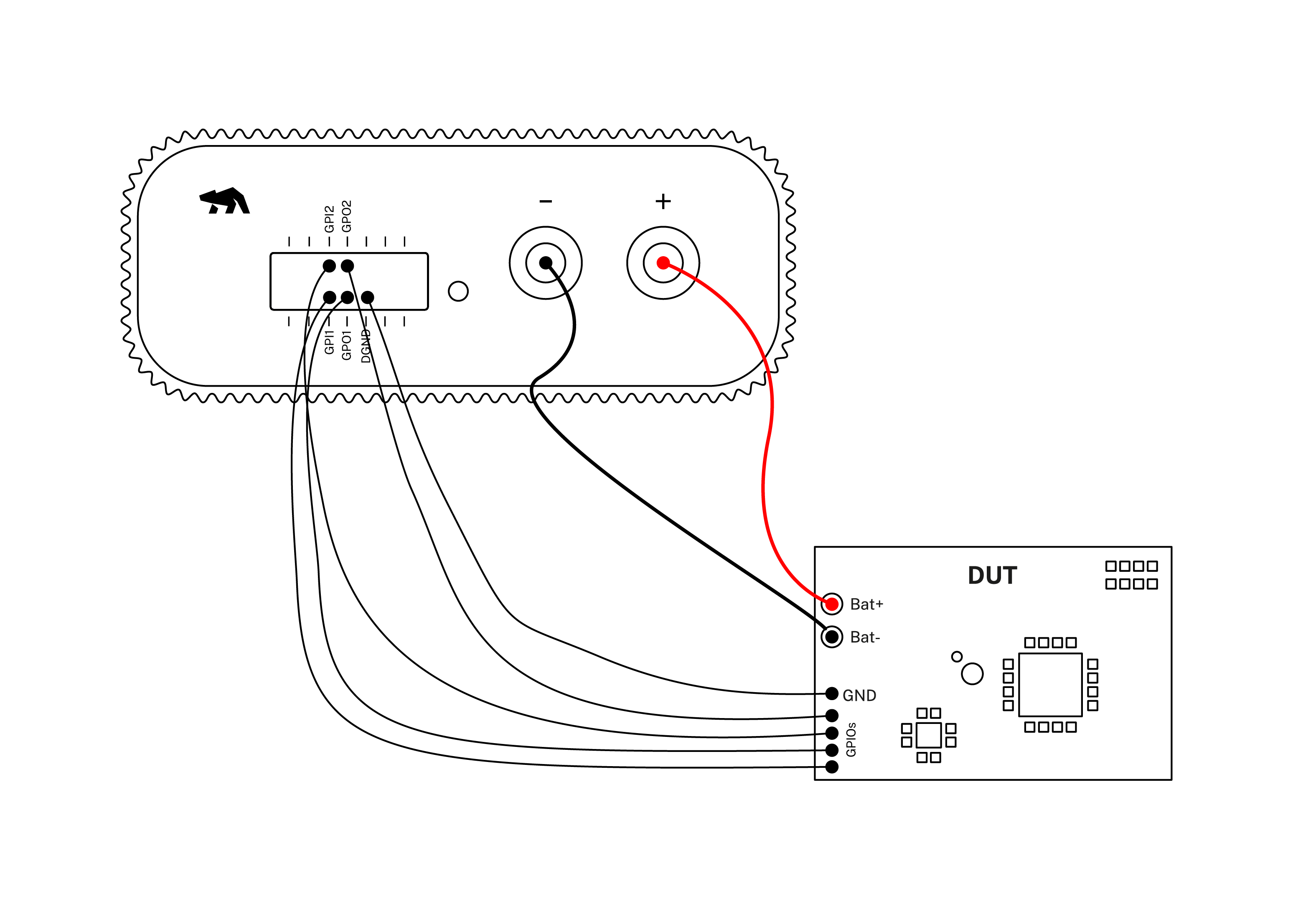

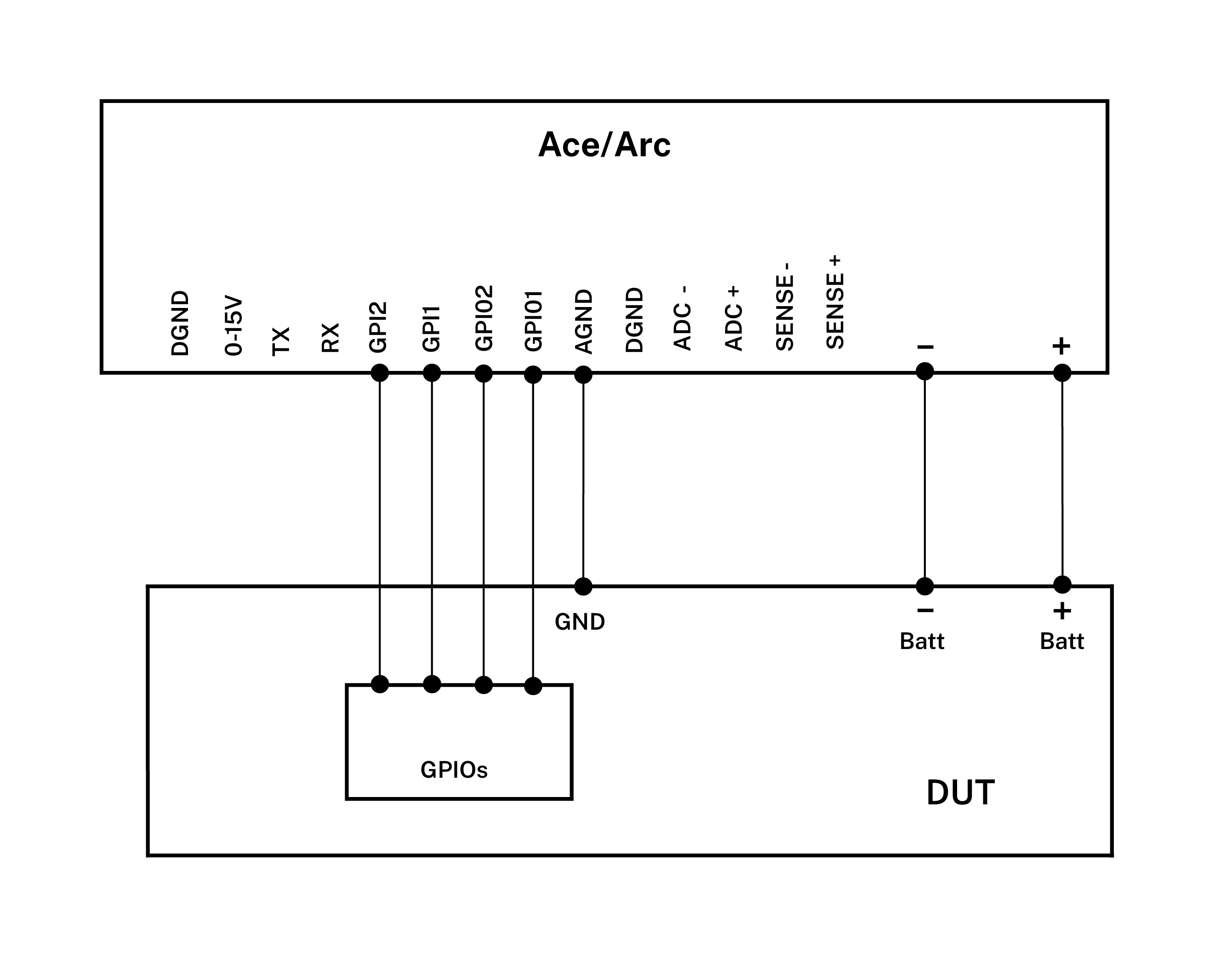

How to connect

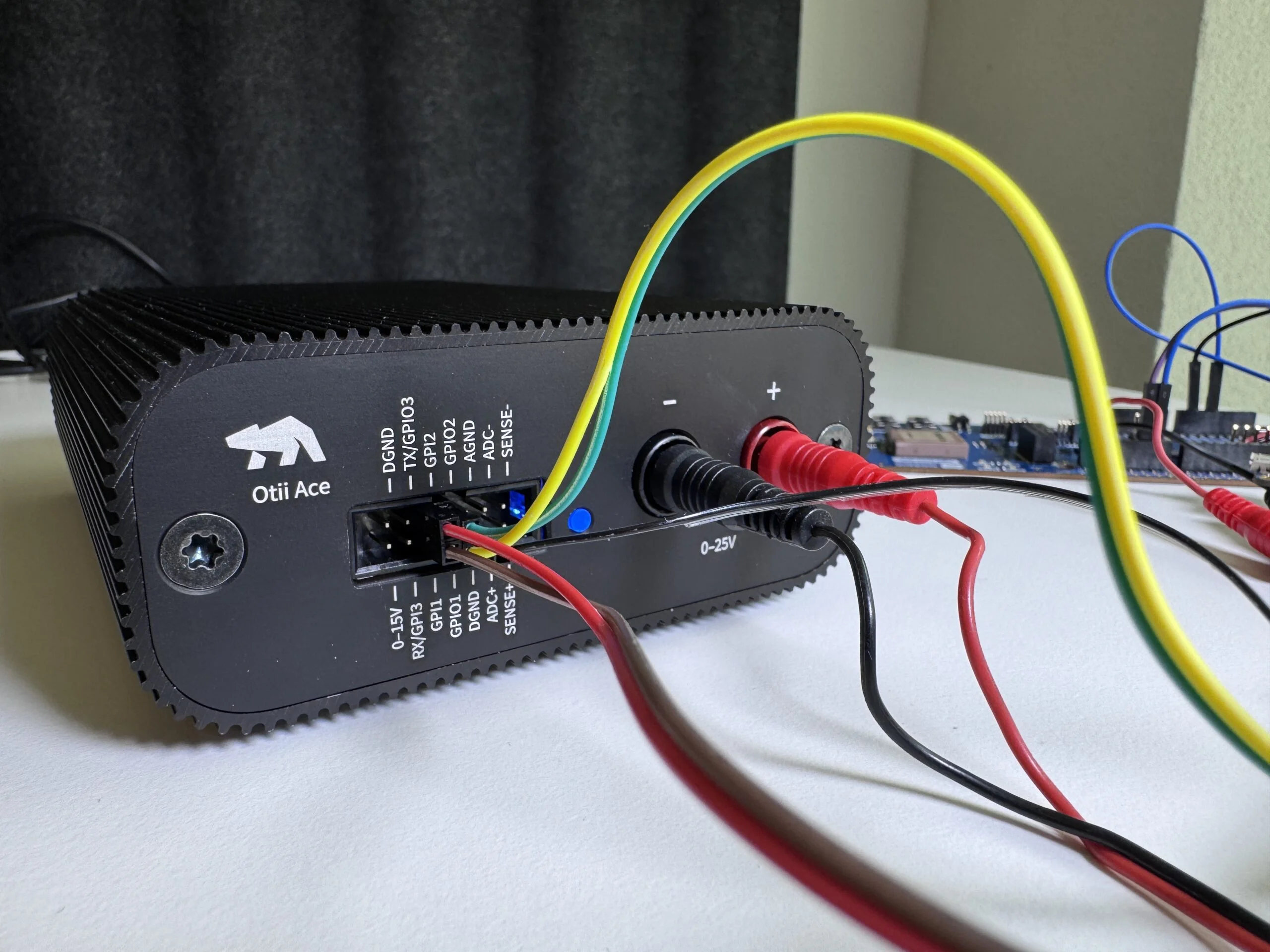

  1. Connect Arc/Ace to your computer by USB. If needed, add a power supply to the DC plug.
  2. Connect Arc/Ace’s banana connector + to the device under test (DUT) positive battery connector/power connector.
  3. Connect Arc/Ace’s banana connector – to DUT negative battery connector/power connector GND
  4. Connect expansion port DGND to DUT GND (DGND and AGND are internally connected).
  5. Connect GPI1/GPI2 to digital outputs on the DUT.
  6. Connect GPO1/GPO2 to digital inputs on the DUT.
Schematics to use Otii Arc/Ace as logic analyzer

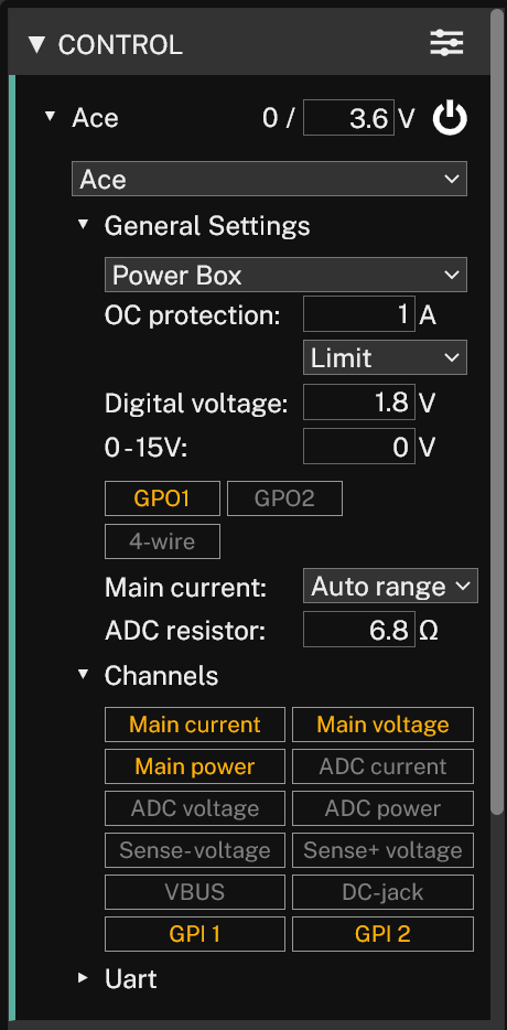

Get started in the Otii application
  1. Add your Arc/Ace under Control in the sidebar. Rename it if desired (right click).
  2. Set up the wanted voltage to supply your DUT with under Arc/Ace. Power box will be chosen by default. Add OC protection for your DUT.
  3. Under ‘Channels’ choose the measurements you want to record, for example main current, main voltage and main power.
  4. Under ‘Channels’ enable GPI1 and GPI2.
  5. Set the correct digital voltage level for your device.
  6. Control GPO1/GPO2 by clicking on the GPO1/GPO2 button in the UI.
  7. Start a recording.
  8. Power the DUT by turning on the supply (On button) next to the Arc/Ace. The data from your DUT is now recorded.
Otii settings for GPIOs
