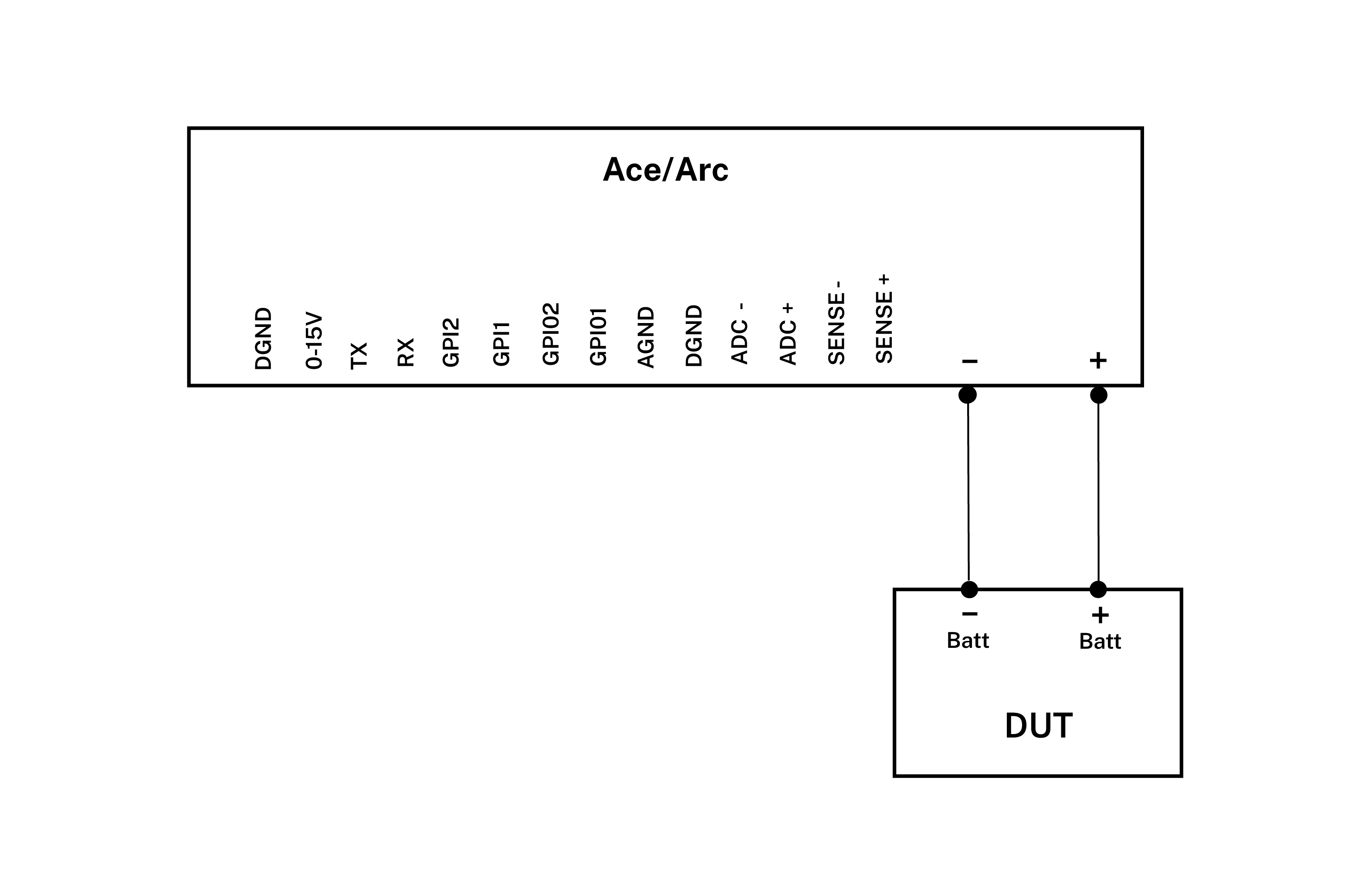

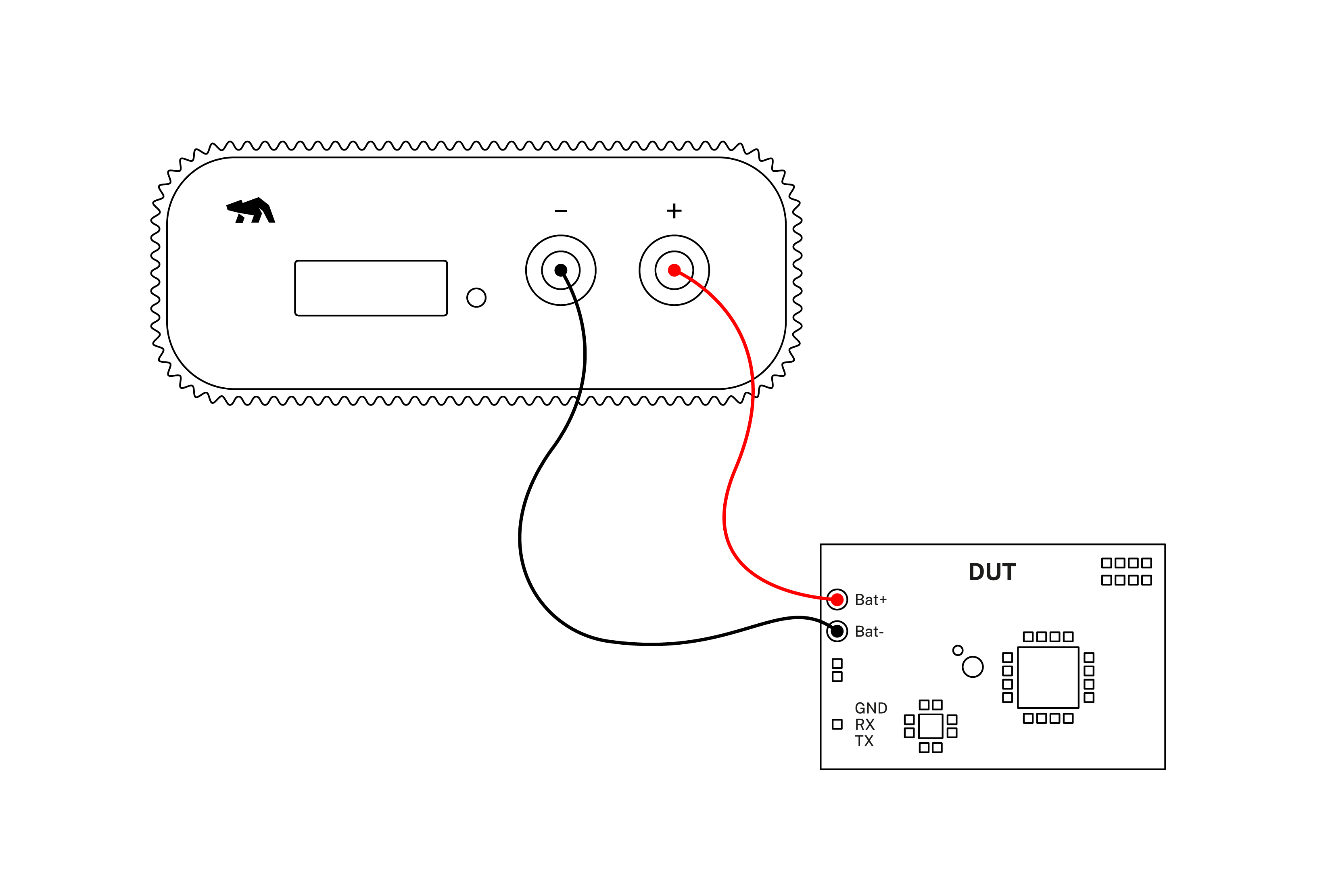

- Connect Arc/Ace to your computer by USB. If needed add a power supply.
- Connect Arc/Ace’s banana connector + to DUT positive battery connector/power connector.
- Connect Arc/Ace’s banana connector – to DUT negative battery connector/power connector GND.

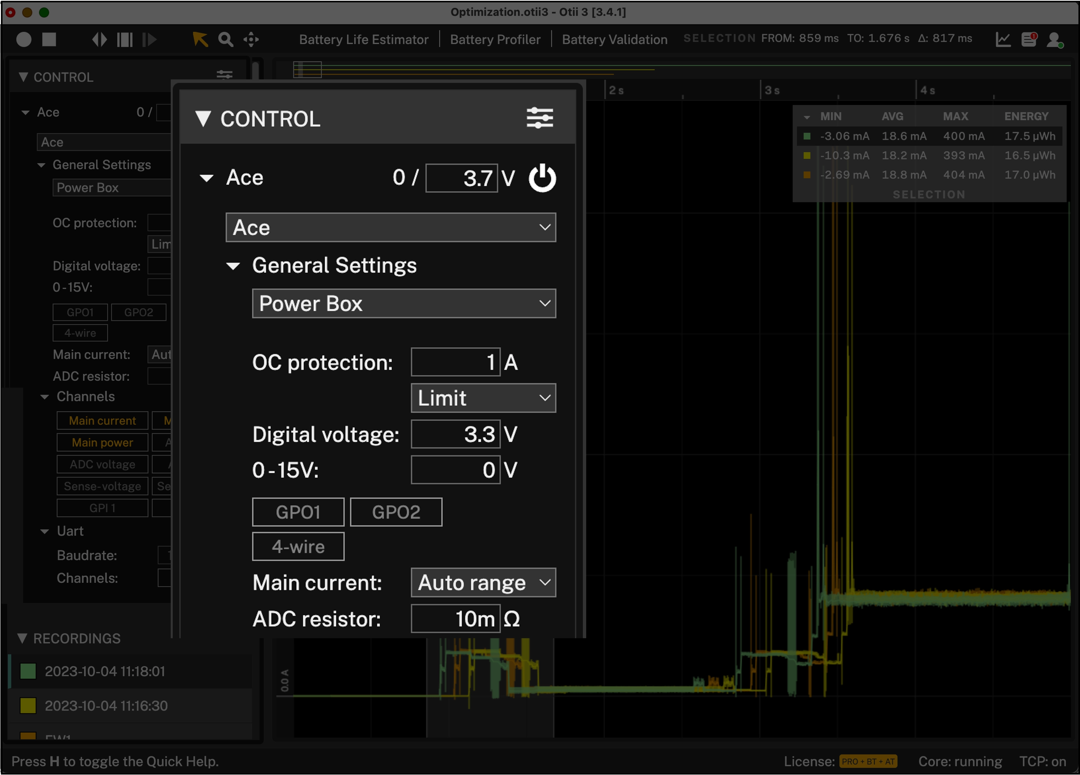

Get started in the Otii application
- Add your Arc/Ace under Control in the sidebar. Rename it if desired (right click).
- Set-up the wanted voltage to supply your DUT with under Arc/Ace. Power box will be chosen per default. Add OC protection for your DUT.
- Under ‘Channels’ choose what kind of measurements you want to record, for example main current, main voltage and main power. These will show as graphs.
- Start a recording. Your DUT is still not powered, and you will only see measured noise.
- Power the DUT by turn on the supply (On button) next to the Arc/Ace. The data from your DUT is now recorded.

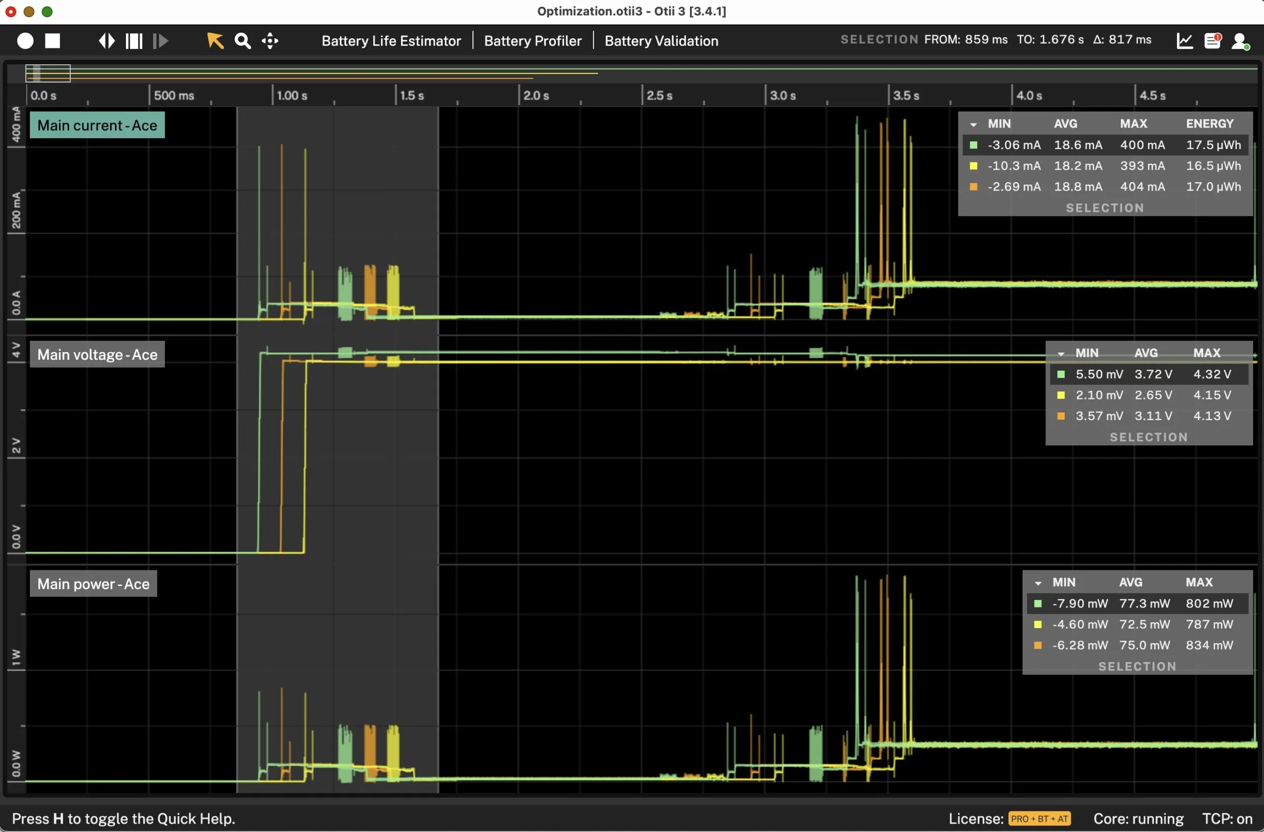

Analyze measurements
- Analyze the measurements. You can make selections based on how you want to view your recording. To show the whole recording, press the Fit Width button in the toolbar, or shortcut W. Auto scale, zoom, drag, or follow graph. There are a few different options for doing this, see in Documentation.
- Analyze min, avg and max values in the statistics section (right corner of the top graph) for the complete recording (Project) or for the viewed recording (View) by making a selection in Settings.
- Analyze statistics for a selected part of the recording by selecting the part of the graph. The values shown are for that selection.
- Compare recordings. You can have several recordings in the same project. Renamed them or change colors to keep track of what was done (right click on the recording name). Sync the recordings for an easier comparison by shifting the current recording in time with Alt + Drag graph.
