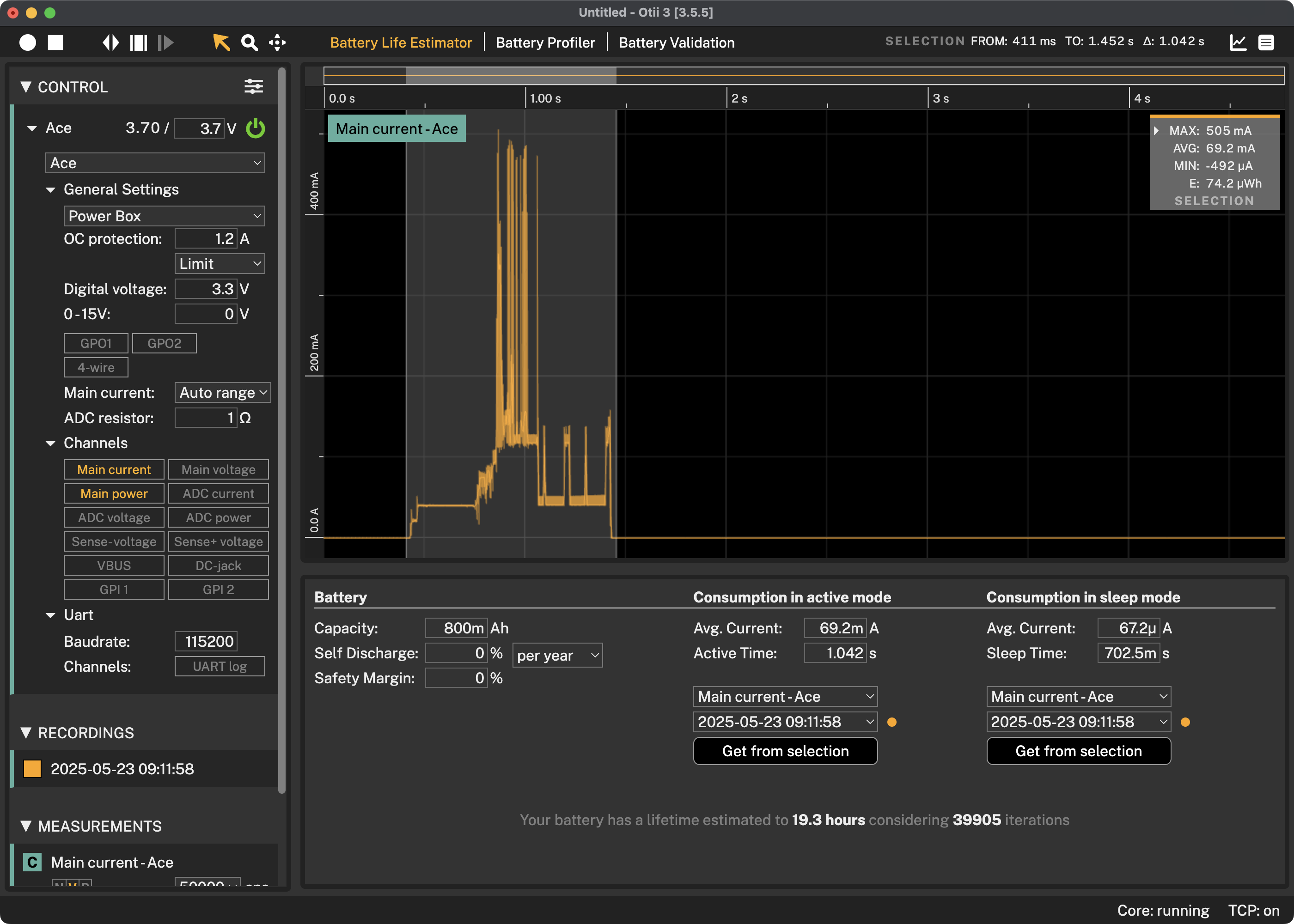

Consumption in active mode
Avg. current
The average current of the active period during the duty cycle.
Active time
The active time during the duty cycle.
Get from selection
Use this to get the average current from the current selection.
Consumption in sleep mode
Avg. current
The average current of the sleep period during the duty cycle.
Active time
The sleep time during the duty cycle.
Get from selection
