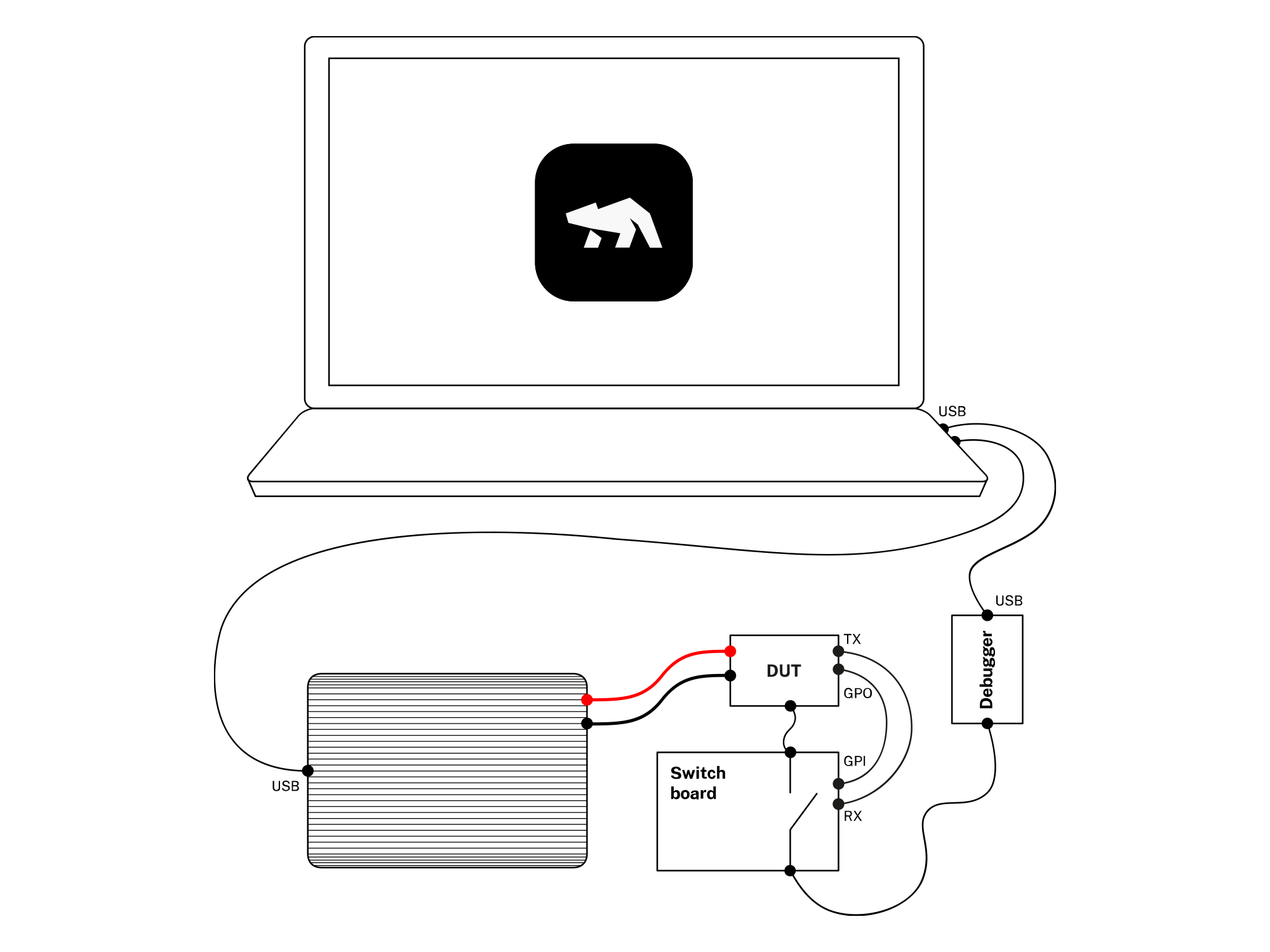

Our test system
In this example we are using a ST32 Cortex M4 programmed with a ST-Link debugger. The board is powered by the Otii, and is connected to the ST-Link using the SWD interface to make it possible to flash the device with new firmware. To get a realistic measurement of the energy consumed, the ST-Link needs to be disconnected during the actual measurement.
For this reason we have developed a simple switch board that is connected to the expansion port of the Otii Arc, and is controlled by the GPO of the Arc. This makes it possible to connect the SWD when flashing the device, and then disconnect it when doing the energy measurements.
The device connects to the RX and the GPI1 of the Otii Arc. These are used in this example to mark the start and stop of parts of the measurements we want to verify.
Jenkins hardware setup
