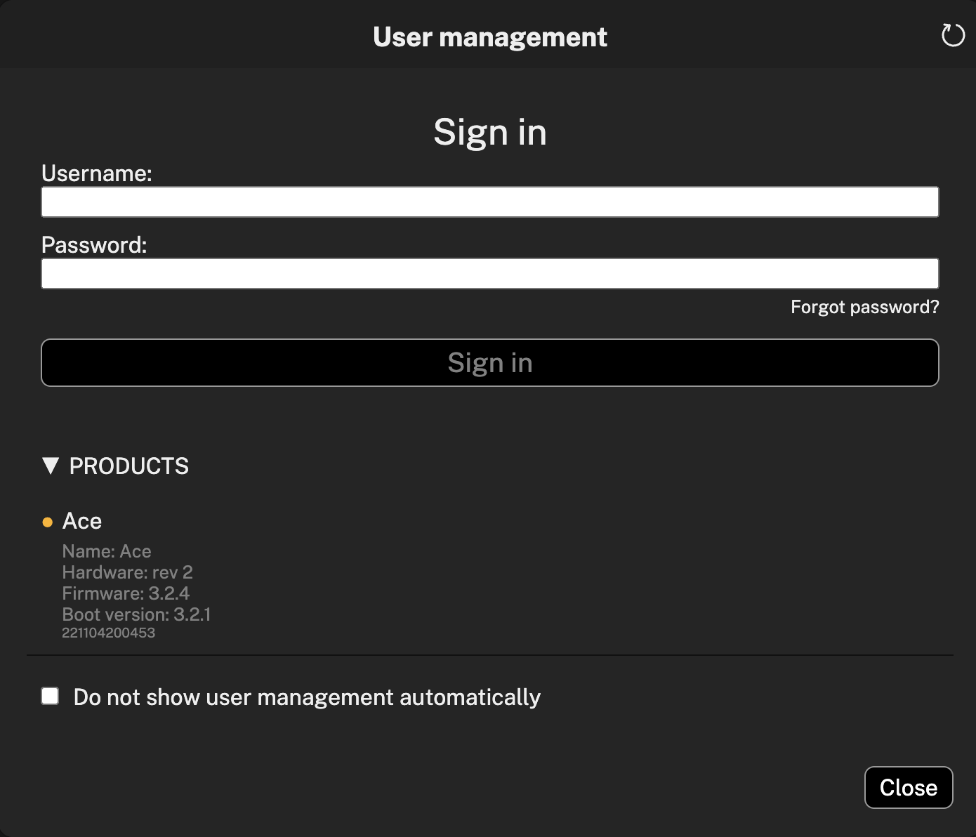

Sign in
Otii hardware connected to the computer will be shown below the sign in form. Enter your username and password, and click sign in to log in. In case of not having an account, refer to this page to create and activate it.

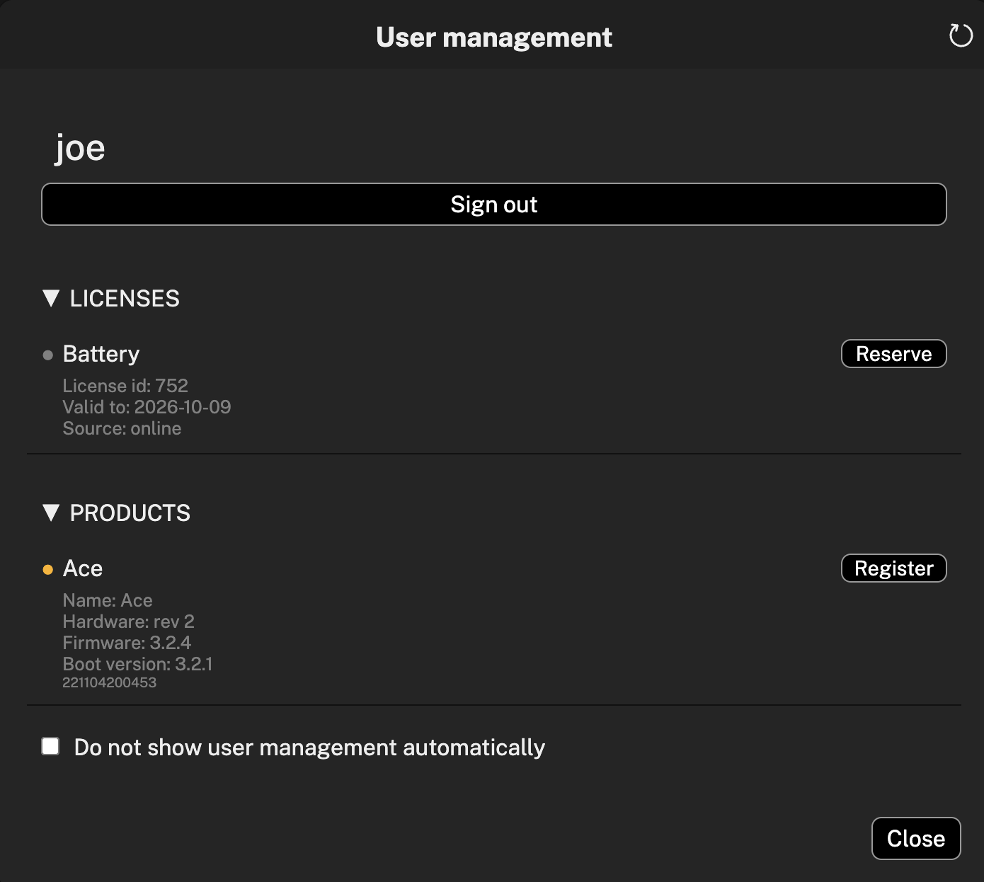

Reserve license
To use the features of a toolbox you need to reserve the license. You click reserve to reserve a license, and the license and its features will be available for this computer until you release it. You can reserve more than one license on a computer.

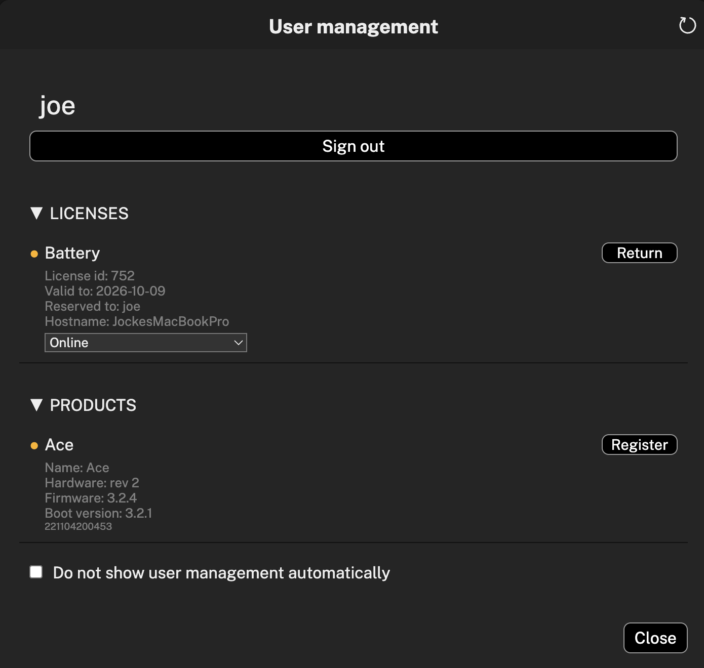

Reserved license will be indicated with a colored dot.

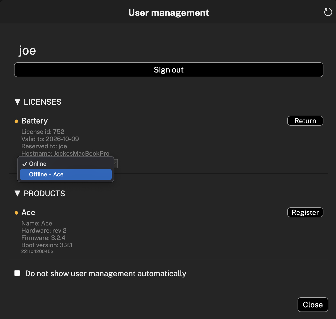

You need to reserve a license to move it to an Otii hardware. When you reserve it a dropbox will be shown at the bottom of the license stating Online. If you click the dropbox all connected devices will be listed, and you can select the device you want to move the license to.

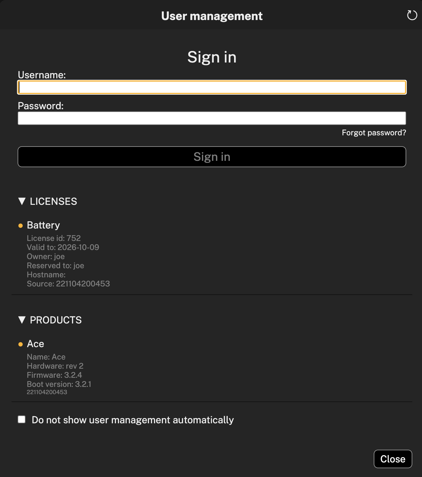

When you sign out, the license will still be available as long as the Otii hardware with the offline license is connected.
Offline license when signed out
