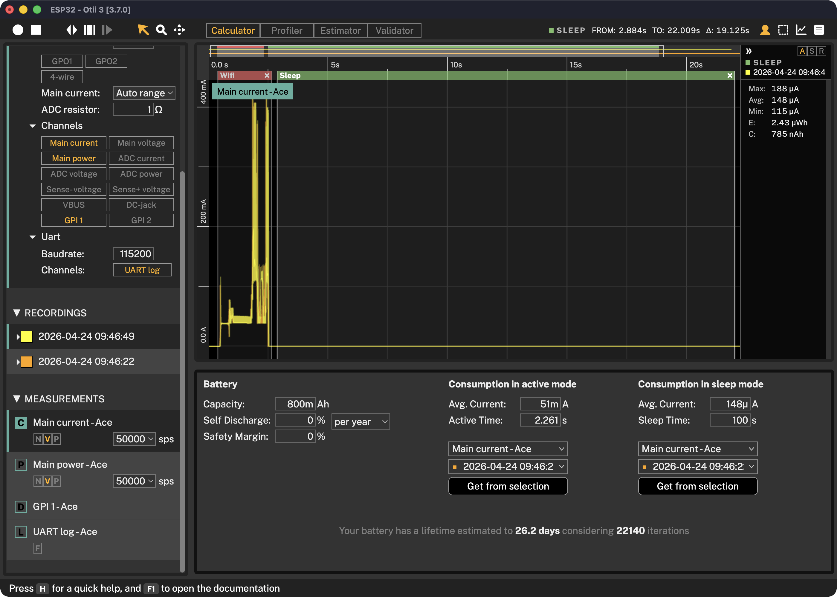

Battery
Capacity
The battery capacity of the battery you want to use. The supported range is from 1 mAh to 999 Ah.
Self discharge
Optionally you can enter a Self discharge in percent and choose the time interval for this value in the dropdown. The self discharge is calculated based on the remaining capacity, for each iteration.
Safety margin
You can also select a Safety margin in percent. This means that estimated battery life calculation will end with the safety margin left of battery capacity.
Consumption in active mode
Avg. current
The average current of the active period during the duty cycle.
Active time
The active time during the duty cycle.
Get from selection
Use this to get the average current from the current selection.
Consumption in sleep mode
Avg. current
The average current of the sleep period during the duty cycle.
Active time
The sleep time during the duty cycle.
Get from selection
