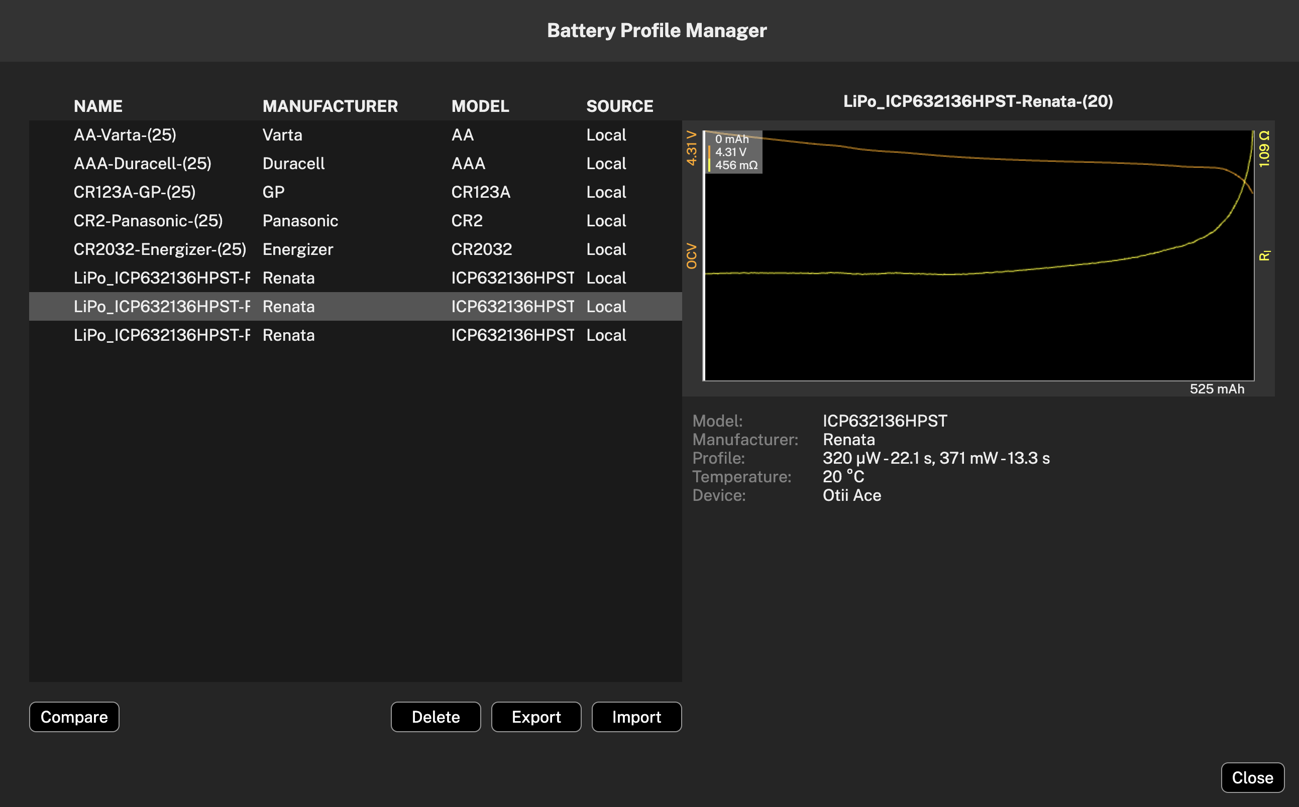

Profile manager dialog
In the profile manager you can see the discharge curves for the battery by selecting a profile.
Battery profile manager

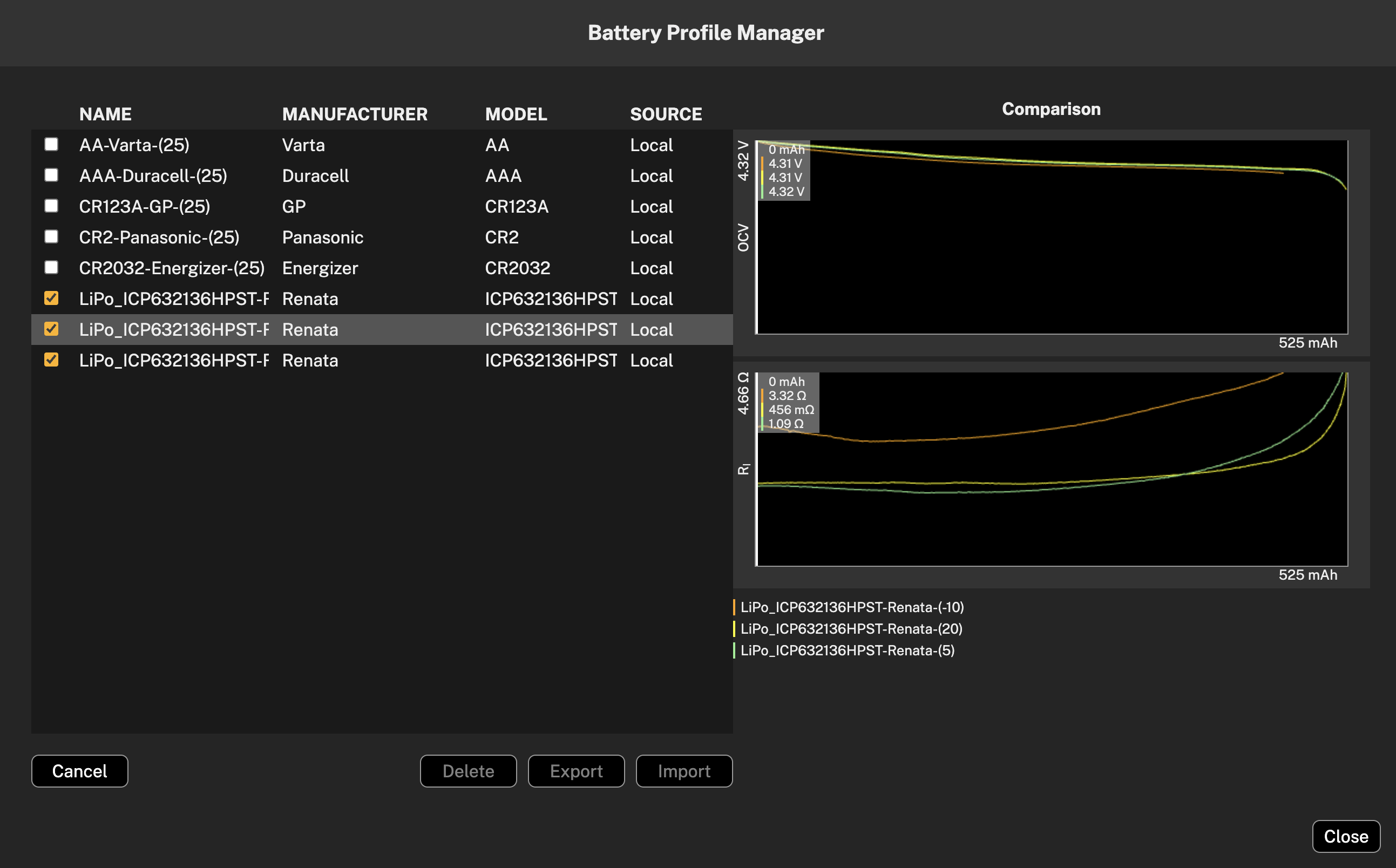

Compare
If you want to compare several profiles, you click on Compare and the select the profiles you want to compare:
Compare profiles
Delete
By selecting a profile you can remove it by clicking Delete and confirm the deletion.
This operation cannot be undone
Export
You can export the selected profile by clicking Export and the selecting a name and a destination.
The profile will be exported in a JSON format, and can be imported into another instance of Otii.
