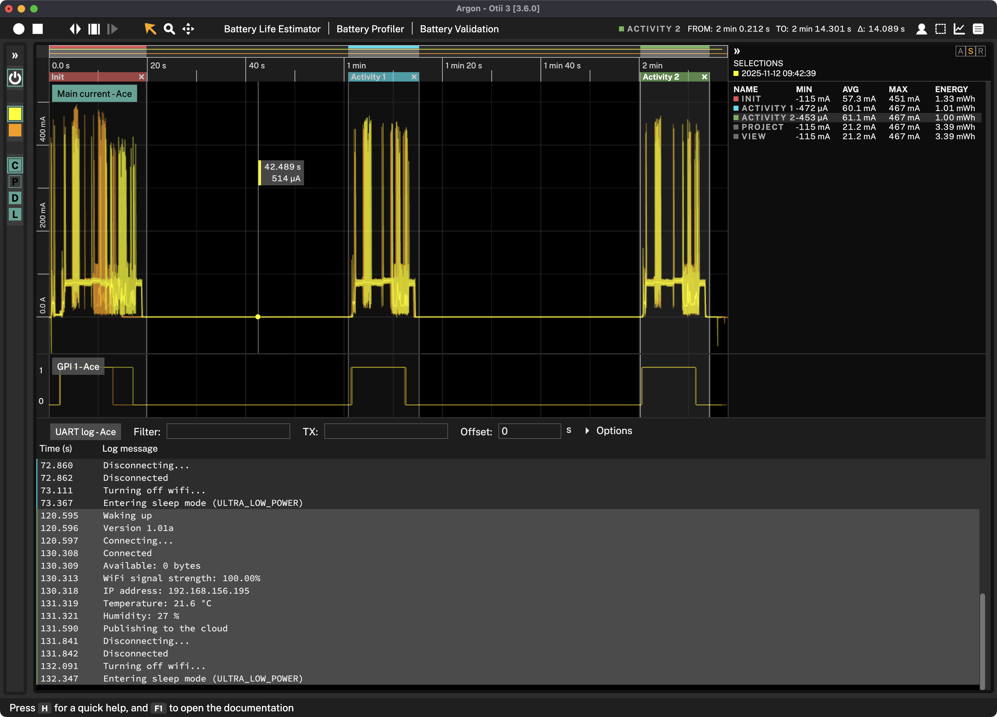

Channels in the Otii 3 Desktop App are different input/output data sources that can be monitored or controlled. These channels enable the measurement of multiple currents, voltages, and power consumption of the main system and sub-systems.
To enable a channel, simply click on the desired channel to be measured. Once enabled, the graphing section will display where the measured values will be logged for further analysis. If a channel is disabled for a new recording within the same project, the associated data will be kept, although the channel will not be included in upcoming recordings.
When selecting a current channel, the matching power channel will automatically be enabled as well, but the power measurement will be hidden by default. The power channel is needed to calculate the energy consumed in the statistics for the recordings.
Channels
Within the channels available for measurement, the following can be found:
  • Main current: include a graph of the current measured at the Otii hardware main connectors in the recordings
  • Main power: include a graph of the power measured at the Otii hardware main connectors in the recordings
  • Main voltage: include a graph of the voltage measured at the Otii hardware main connectors in the recordings
  • ADC voltage: include a graph of the voltage measured at the ADC connectors in the recordings. This is measured on ADC+ pin. Single-ended from ADC+ to AGND; see an example of how to connect the ADC to measure voltage
  • ADC current: include a graph of the current measured at the ADC connectors in the recordings. This is a differential measurement between ADC+ and ADC- pin; see an example of how to set the ADC resistor
  • ADC power: include a graph of the power measured at the ADC connectors in the recordings
  • SENSE +/- voltage: include a graph of the voltage measured at the SENSE+ and/or SENSE- pins in the expansion port. Single-ended measured compared to AGND
  • VBUS: include a graph of the VBUS voltage
  • DC-jack: include a graph of the DC-jack voltage
  • GPI1 & GPI2: include a graph of the signal measured at the GPI1 and/or GPI2 pins in the expansion port. These pins are digital, and their value depends on how you have configured your digital voltage level in the supply mode
UART
UART (Universal Asynchronous Receiver/Transmitter) is a device-to-device communication protocol that allows interface and talk to exchange among devices. Within the Otii 3 Desktop App, the UART settings allow engineers and developers to:
  • monitor and analyze data transmitted directly from the device under test (DUT) to the Otii 3 Desktop App
  • or transmit data directly from the Otii 3 Desktop App to the DUT; for example, send AT commands to the DUT while simultaneously observing the behavior and response via the console log.
By capturing and analyzing the UART data displayed within the Otii 3 console log, developers can gain insights into the DUT's behavior and precisely identify and troubleshoot any issues that might be causing the DUT's energy source-drain.
You can either use the built in UART of your Otii hardware, or you can use use a third party USB UART.
Enable the UART of your Otii hardware
  1. While configuring the DUT in the CONTROL section of the Otii 3 Desktop App, navigate to the last setting option: Uart.
  2. Set the baud rate on the respective field. To guarantee serial communication, assign the same baud rate as the one assigned in the DUT.
  3. Enable the serial communication in the Channels option by clicking the UART log button. Upon enabling it, the console log will be automatically displayed at the bottom section of the Otii 3 Desktop App.
Otii UART settings
Once activated, with the additional connection required to establish serial communication between the DUT and the Otii hardware, the data transmitted will be displayed on the console log after the power supply is switched ON and the recording starts.
Enable an USB UART
If you have a third party USB UART connected to your computer it will be shown below the Otii hardware with the name of the computer device it is connected to. To add it, click the Add button.
USB serial
Set the baudrate of the device and click in UART log to enable it for recording.
USB serial settings
